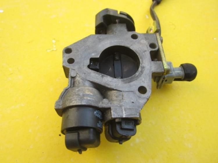

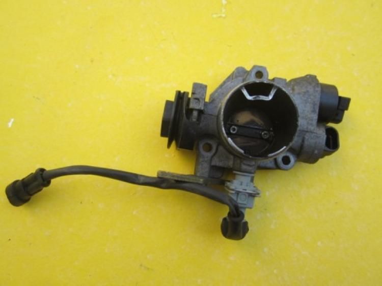

yes i think it needs taking off , get advise with what you can squirt into the throttle body, prob carb cleaner, not sure if a petrol additive for injector would help if clogged with the dirt getting in, some photos of the throttle body to see what you looking at: this one the only one i could find for sale in italy with an offer price they want £70 delivered but you could get it down a bit, anyway worth watching.

you can see the connections, and the workshop manual states
Intake system cleaning
Air filter ( have a look at condition)
Diffuser and throttle valve
Additional air pipe and Stepper ( the throttle body may have this additional pipe on and may be clogged, i know carbs have an air pipe and if that is blocked fully it starves the fuel mix, so could be slightly blocked......
Intake system sealing (infiltrations)
Intake manifold - head ( could all need re-sealing)
Throttle body - manifold
Intake sleeve
Filter box
so gaskets or use whats there and gasket sealant, hope everything works out :D
what the manual states regarding throttle body:
THE THROTTLE BODY IS A PART WHICH INCLUDES VARIOUS COMPONENTS AND IS USUALLY
SUPPLIED COMPLETE. TO TEST THESE COMPONENTS SEE THE "INJECTION" CHAPTER.
to take off Remove the 3 retaining screws
CAUTION
THE THROTTLE BODY COMES PRE-CALIBRATED. TAMPERING WITH THE THROTTLE STOP
REGISTER IS TO BE ABSOLUTELY AVOIDED. THIS REGISTER HAS BEEN SEALED FOR THIS
PURPOSE. FOR PROBLEMS WITH IDLING SEE THE "INJECTION" CHAPTER.
N.B.
REMOVAL OF THE THROTTLE BODY CAN BE EFFECTED WITH THE MANIFOLD ON OR OFF
THE ENGINE.
Make sure the seal rims on the coupling surfaces
between the manifold-throttle body and manifoldhead
are in good condition.
CAUTION
IF AIR GETS IN IT CAN JEOPARDISE THE OPERATION
OF THE INJECTION SYSTEM, ESPECIALLY
WHEN THE ENGINE IS IDLING.
Make sure the throttle valve and related conduit
are clean.
- Make sure the supplementary air channel managed
by the stepper motor is clean.
N.B.
IF THE THROTTLE BODY IS REPLACED with another one, RESET THE T.P.S. AND ADJUST THE CO%.
ONCE THE ENGINE IS REPAIRED CHECK THE CO% VALUE WHILE IDLING TO MAKE SURE IT
IS WITHIN THE PRESCRIBED VALUES.
