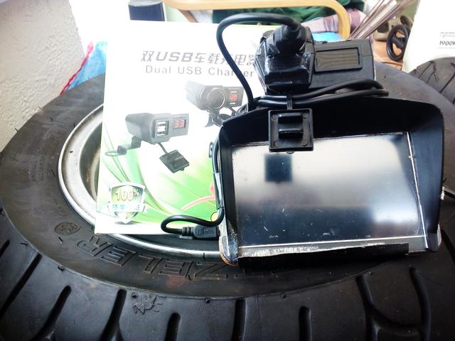

Change of plan with USB and volt meter bit of sticky pad and gorilla tape bodging .Now mounted on top of GPS so all comes off in one shall just plug it in in glove box .That way nothing left to steal when left outside hotels .Hopefully new xmax 300 and other vespas will attract more attention 6 scoots in total going .

Is that a DIY waterproof housing for the SatNav?

Its not water proof one but will be sitting well behind screen just above dash .I've used non water proof Chinese ones before on tours tucked out of the way been fine .Its got a sunshade taped on as well .

Tried it in car as know socket works on that one and saved me taking cover off scooter .One of things can go on tour is volt reg or stator or can cook the battery .At least get bit of warning with voltmeter .I know they add them on new ones now but not on mine .Handy in car or van as well .

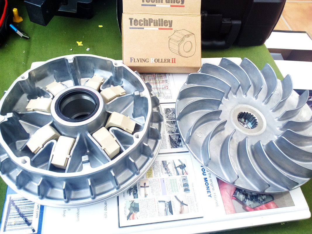

New variator has arrived along with Dr pulleys with wings .Variator on burger at moment has done 36 k if its the original worn in midsection and that can cause belts to wear prematurely.
